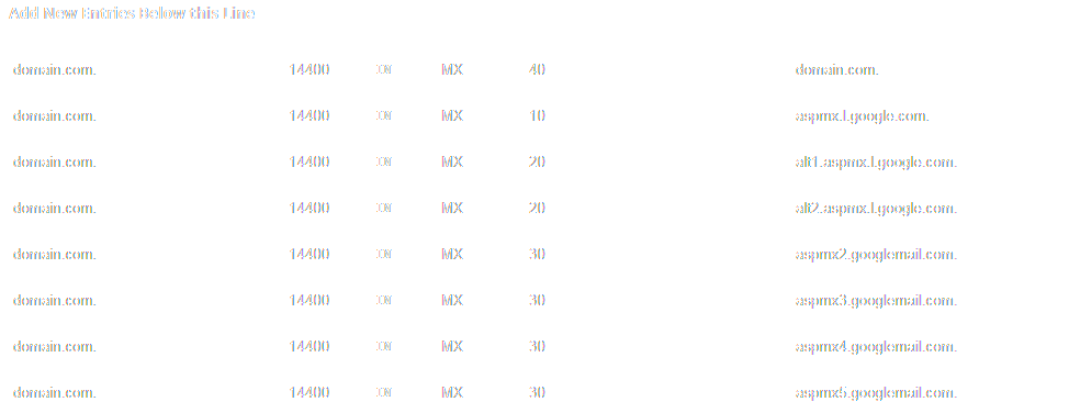

You said you have your email at Google but your DNS report shows that your MX records do not reflect this, you only have one MX record and it's pointing to the local server IP so your email will never get to Google's servers. You need to modify your DNS zones that will be using G Suites. In your G Suite dashboard click the three dots in the upper right corner and pick Setup, that should walk you through it but pay particular attention to the Gmail setup as that's what we're concerned with here. You should be adding MX records to your DNS zones similar to this:
580
The first in the list is your current MX record pointing to your local host which you will find up above with a priority of 0, change it's priority to 40 (higher number = lower priority) so email will go to Google's servers first but if they're down then your server will collect the email and when Google comes back it will forward the email on.

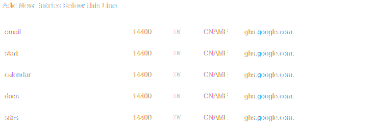

I would also recommend adding the following records:
581
These will make it so you can go to email.mydomain.com to log into your email and to docs.mydomain.com to log into Google docs.
