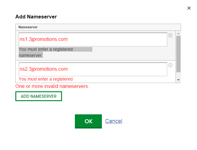

I have a domain in godaddy and want to point it to the name servers here in knownhost,
each time I enter the custom name server, godaddy gives me an error message; "You must enter a registered nameserver."
I dont understand why is this happening, upon checking my VPS CPANEL/WHM, the name server is properly setup (at least based on what I see)
any thoughts on this? I have attached the screenshot for the godaddy error

Hi David, thank you for your response on this, Yes I do need assistance, you see, my main domain; 3jpromotions.com is on godaddy, and whenever I tried changing the nameservers, it shows an error like on the image I attached on the first post on the top, it says on your email and I quote below
"You need to create the following name servers at your registrar:
ns1.3jpromotions.com using IP 204.197.xxx.xx
ns2.3jpromotions.com using IP 204.197.xxx.xx"
I did that on the WHM, but when I add those two nameservers, the error appears,
is there anyway I can make 3jpromotions.com my main domain for my VPS?

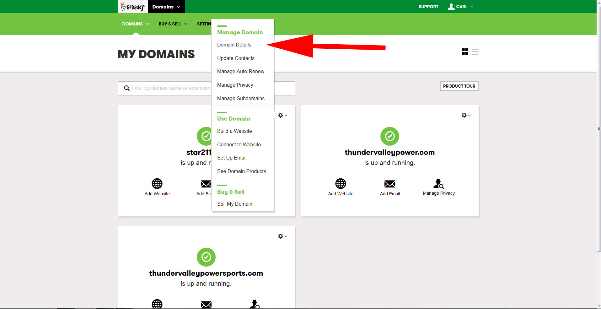

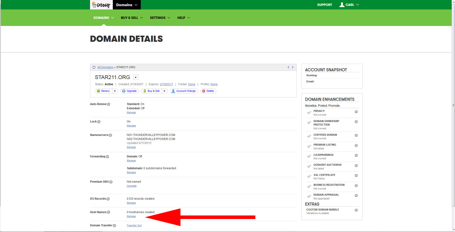

The post from doulos gave me enough information to finally track it down. Godaddy does not make it easy. Here are the steps (with more description):
1. login to godaddy

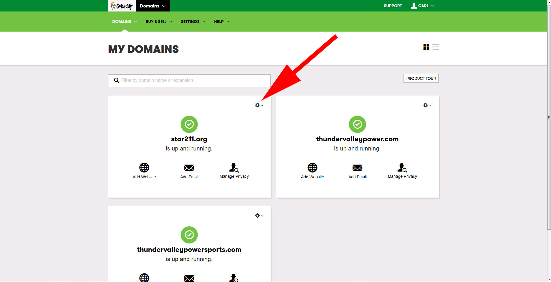

2.From the "Domains" drop down at top left choose "All Domains". This will show you a grid with your domains, you might only have one.
3. At the top right box for any of your domains click the asterisk looking settings icon. (you should be able to register the nameservers from any domain).
4. A menu will pop up. Choose "Domain Details"

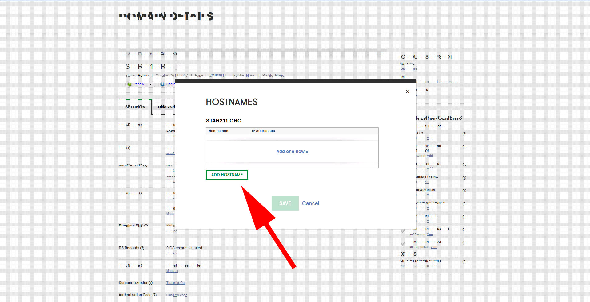

5. Look at the left column of the details page. The sixth row is "Host Names". The next column probably says "0 hostnames created". Right under that is a link that says "Manage". That link will let you register your name servers.

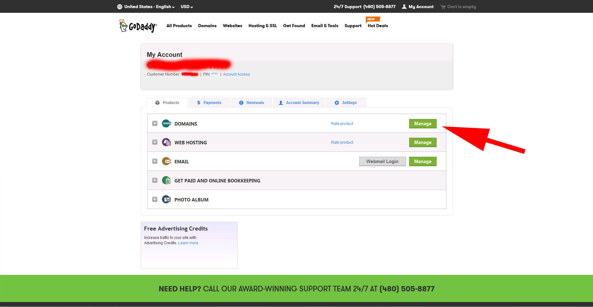

So I went back into my account to test my instructions. When your first log on "Manage Domains" is on the main screen.
Since I wrote the instructions that Manage link in step 5 has quit working for me. Godaddy has slick advertising but their web interface is one of the poorer I've seen. Good luck!
Or just call their customer support and make them do it.

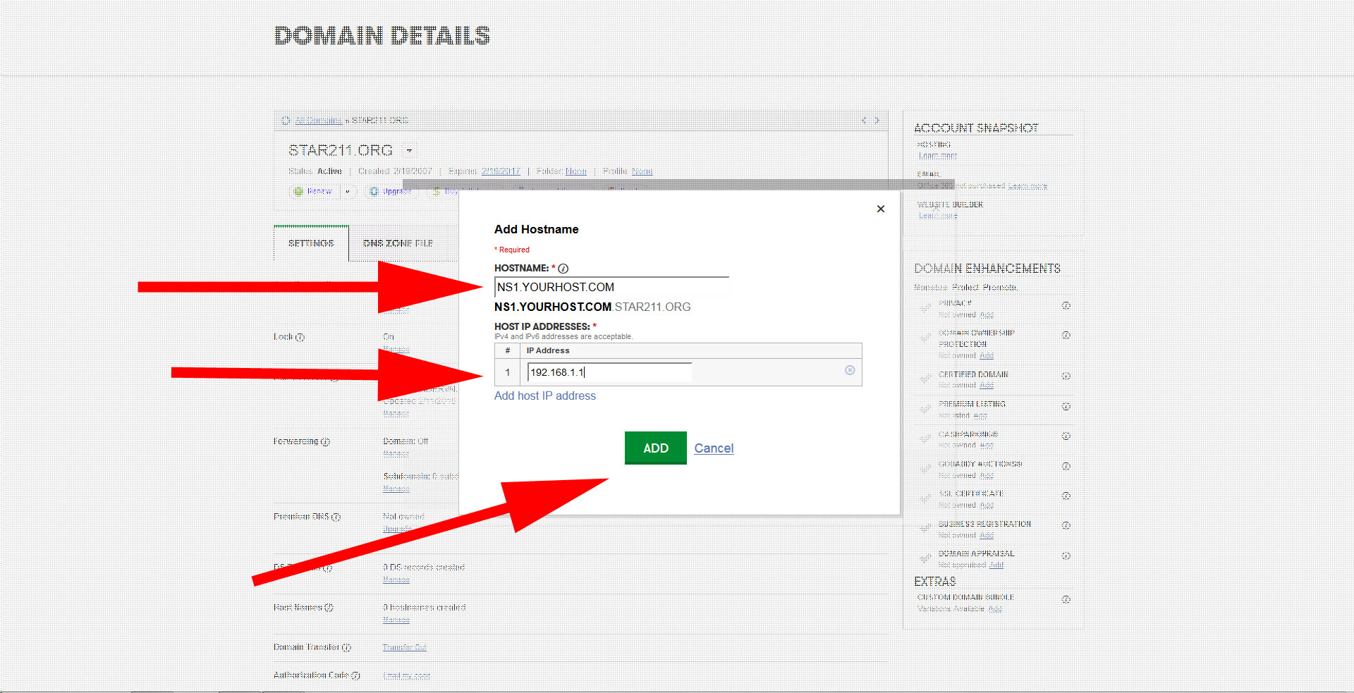

Ok. Picture tutorial.
Use your first nameserver and IP address in step 6. Repeat step 6 for 2nd nameserver and IP address. Then click "SAVE".
